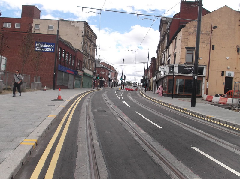

Here some picture in Rochdale that I took this afternoon for the Rochdale Town Centre line.
Metrolink line on Maclure Road (Rochdale)
I wonder how many people will still drive they car onto line here knowing the put this down?

Drake Street is lot better with fences have been took away now and road is fully open after two years of closed.
Metrolink line running on Drake Street (Rochdale)
Metrolink line running on Drake Street (Rochdale) 3
I bet you still got people driving down Drake Street knowing they put this down on road.

You'd be surprised how many people manage to drive along tram only roads including continuing onto sections where the rails are no longer flush with the surface and the car drops into the gap. Those yellow bollards have appeared all over the network following several such incidents. Sometimes I think a sight test is no longer necessary for driving!
