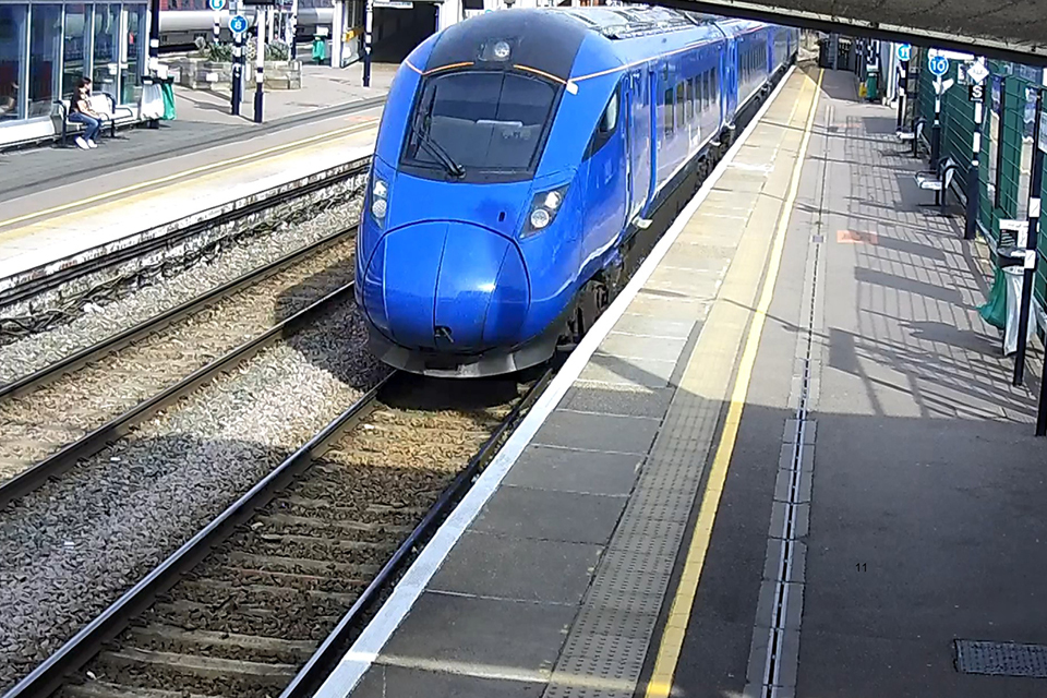

Today’s RAIB statement is here:
At around 10:20 hrs on 17 April 2022, the 08:20 hrs Newcastle to King’s Cross service, operated by Lumo, passed over three sets of points at the north end of Peterborough station at a speed of 75 mph (121 km/h). This was above the maximum permitted speed limit for these points of 25 mph (40 km/h). Passing over the points at this speed meant that the train suddenly lurched sideways.
The sudden movement of the train resulted in some passengers being thrown from their seats and in luggage falling from the overhead storage in the passenger compartments. This resulted in a number of minor injuries being sustained by passengers. The train subsequently came to a stand beyond the far end of Peterborough station. The train did not derail during the incident, and no damage was caused to the infrastructure of the railway, or to the vehicles involved.
The train involved in the incident was not due to call at Peterborough and had originally been approaching the station on a fast line, before being routed onto a slower line via the points where the overspeed occurred. The route onto this slower line was being displayed on the signal situated on the approach to the points.
Our investigation will seek to identify the sequence of events which led to this incident. It will include consideration of:
  • the way in which the train was driven
  • any factors which may have influenced the actions of the driver of the train
  • the condition of the signalling system at the time of the incident
  • the nature of the reported injuries
  • any underlying management factors.
So there we go, it's in black and white that the injuries weren't caused by the 'emergency stop' as Lumo misleadingly claimed, but by the lurching resulting from the overspeed. Not that that's any surprise.
20,471
This is a pretty poor showing from Lumo. As we knew, not an emergency stop, but running through points at three times the permitted speed, which they would have known about pretty soon after the incident.
