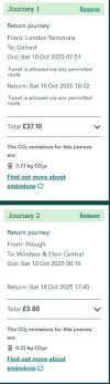

Im trying to find the cheapest option to go from london to windsor then oxford and back to london in a single day. However I dont quite understand the ticket types
Can I just buy a return ticket london - oxford and do I detour to Windsor if the ticket says travel is allowed via any permitted route?
If not, can I simply add a return ticket slough-windsor and do the mentioned whole trip?
With the 2 return tickets can I go london to slough, slough to windor and back then slough oxford and lastly oxford to london. 2 tickets attached

Your second option is fine, leaving Paddington after 0920 or any time at weekends, as you are allowed to break your journey.
The first isn't as you are doubling back on the Windsor section.
Experts on here may be able to advise about a 3rd option, starting from Waterloo and travelling to Windsor and Eton Riverside, continuing later from Central, but the NRE planner says it's not valid.

Correct, permitted routes are WX+RB, LH & GC at https://rgpp.iblocks.co.uk/maps, none of which includes Windsor.
Presumably via Windsor is more than 3 miles further than 63m 26ch Paddington-Oxford also. Or a Windsor walking link isn’t defined.
However some journey planners may offer Waterloo-Windsor-Slough-Oxford, from an old thread https://www.railforums.co.uk/thread...lid-via-windsor-stations.206505/#post-4668574

Essentially, a Slough to Windsor return is a simple and safe option here.
