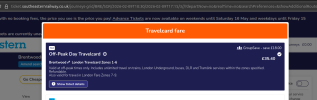

Seeing as you've posted online in such a way as to create a paper trail proving you're aware these tickets are not valid for a group of 3, I concur you should try to get them changed for three outboundary Travelcards from somewhere like Amersham or Brentwood, with a GroupSave discount.
Were it not for the existence of this thread I would say the tickets you have been sold must be valid. If a ticket office sells a ticket, it has to be valid. There might be route or time restrictions on when it is valid, and you might have to carry another ticket or Railcard to make it valid (which the ticket office should have checked at time of purchase), but I struggle to see, contractually, how a set of tickets could be flat-out invalid and totally useless if an accredited retailer such as a ticket office sold it to you.
Not much difference in price anyway - just the extra cost of a bit of unwanted validity outside Z1-6 in order to trigger the entitlement to the GroupSave discount.
