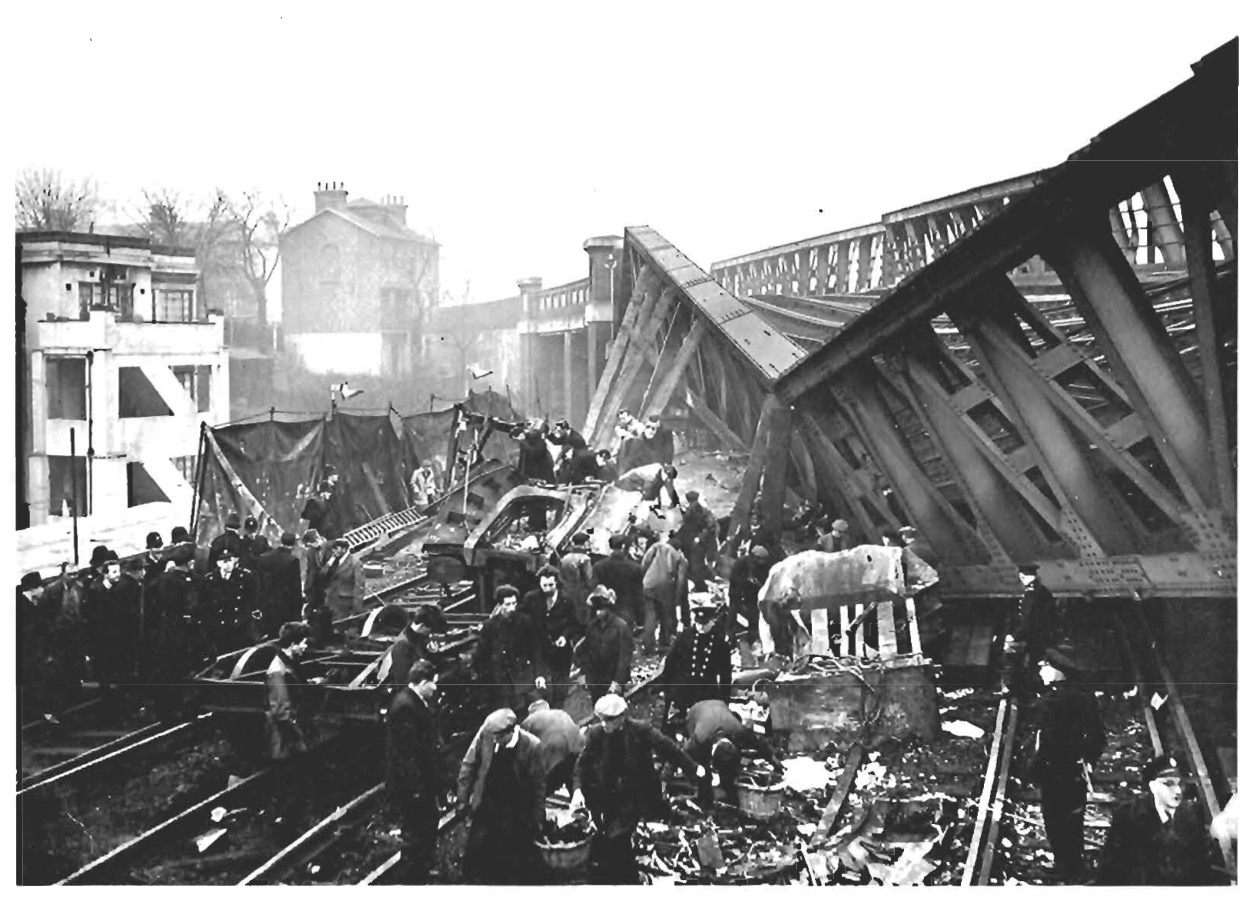

It was built by military as a quick replacement of previous bridge destroyed during the rail crash in 1957:

The 'temporary' bridge uses military bridge components, but was designed and erected by the Southern Region of British Railways. The military helped by loading the required items into wagons from their store on the Longmoor military railway. A very detailed description of both the clear-up of the old bridge remains and the erection of the new is given in "St John's Lewisham 50 years on" by Peter Tatlow, published by The Oakwood Press in 2007, ISBN 0 85361 669 6. The accident happened on the 4th of December, 1957 and the temporary bridge was first tested on January 12th, 1958, a remarkable achievement!
At various times in the ensuing years there were plans to design and build a new bridge, but in the end the disruption to trains this would cause was decided to outweigh the costs of maintaining the temporary structure, and some minor alterations have been made.
