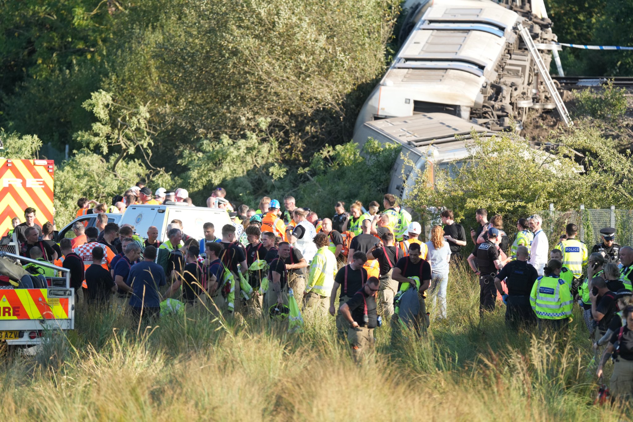

Images by @brightonsnapper on Twitter.
HPooTQ0X0AAhYkf
HPoof8CWgAAnb56
Some great photos on this account, I have not added them all.
HPooTQ0X0AAhYkf
HPoof8CWgAAnb56
I don't know why but I find the police tape mildly amusing in the first photo. Anyone approaching the scene would already be committing criminal trespass but they definitely mustn't go behind the tape!
(Yes I'm aware why it's actually there)

I wonder if the trackside vegetation actually helped quite a lot in breaking the fall of the overturned carriages.
HPooTQ0X0AAhYkf
HPoof8CWgAAnb56
Maybe I have missed this in 7 pages of posts but did the 3 rear coaches seen on their side stay nominally upright until the train came to a halt? If so that would have helped mitigate injuries.
Looking at the first picture the trackside trees etc. behind the train appear not to have major damage.

The scotrail
Quite possibly yes.
I don't think that's the case - in the photos posted early in the thread it is possible to get a good iead of where thet vehicles went after leaving the rails and, to me, it looks like they simply managed to avoid most of that vegetation.
Based on listening to the interviews on the BBC with people who were travelling in the derailed carriages, basically they rolled over onto their sides/down the embankment as the train stopped.
There was obviously enough energy in the collision for the large tree to be flattened by the rearmost carriage.
Possibly with the roots taking a chunk of embankment with it.
Maybe wider issues with trees allowed to grow trackside.
