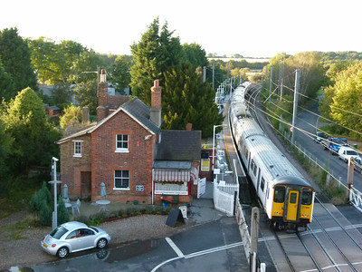

Speaking of which, has a footbridge been provided at Elsenham now?
Was where this photo was taken from!
