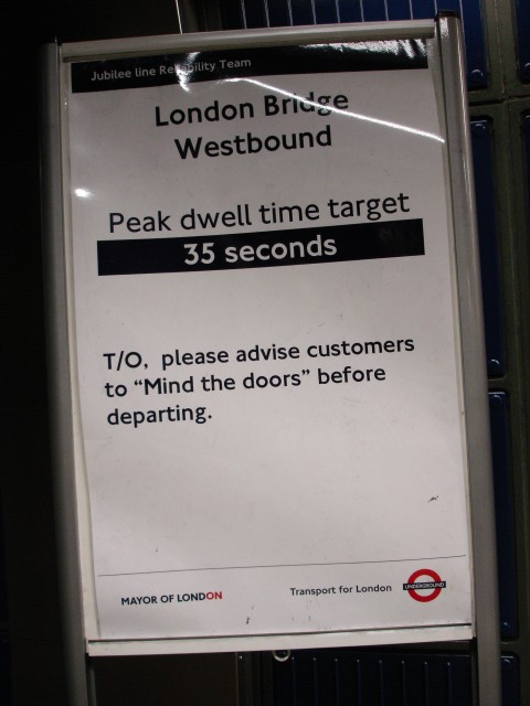

Mojo
7 Aug 2005
21,170
0035
I've seen these signs at a few places on the Jubilee line for Train Operators, so I'd assume that something close to that must be possible, otherwise they wouldn't say it!

Daniel
5 Oct 2005
2,563
Most dwell times are in the area of 30-40 seconds.
This is from the time enters the station platform and leaves the platform, not the time which it is standing.
Not that I count, but I don't think it's often accurate. The better line for the dwell times are on the central line, for example, as there is an indication in the cab for the driver as a countdown to when he should be moving.
Note, however, that is about dwell times, (see the photo in Mojos post), not headways, (the thread topic)
