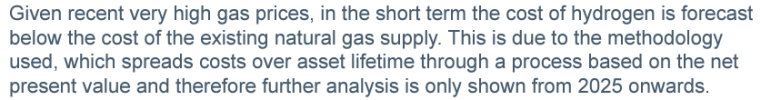

An easier solution to managing fluctuating demand is to move to Hydrogen to replace the existing Natural Gas. Hydrogen can be produced using renewable energy and transported using the existing grid - work is ongoing to test and prepare the gas grid. We can then continue to use the majority of our domestic gas appliances, even moving to a domestic combined heat/power boiler. This can be supplemented by wind and solar for domestic use, with the grid hydrogen providing the buffer for times of peak demand.
reddragon
24 Mar 2016
3,274
Churn (closed)
This is the worst and most ill informed answer that is possible. You have been conned by the Fossil industry here.
A huge amount of energy is required to convert water to Hydrogen, it is very inefficient with only a third of the electric energy is converted into gas energy. Other storage mediums convert 90%+ to electric or heat.
Ministers’ plans to pin the UK’s energy hopes on hydrogen could nearly double the cost of heating a home by the end of the decade compared with natural gas, research has shown.
Who is going to fund the cost of replacing all the pipes & appliances in homes to switch to hydrogen because no they cannot use existing assets. All that is possible is a local industrial network for certain industries that are harder to electrify, then only in the medium term, too little to get a return on the investment. Hydrogen is very difficult to contain within a pipe and is much more dangerous to use than methane. BOOM!
Hydrogen is also a very inefficient of creating electric for the grid or in a vehicle, which is why EVs dominate and only Toyota still make a hydrogen car, they cost too much and are worse than an EV despite billions being spent on development.
The MCS report you cite via the Grauniad article is unreliable and is cherry picking figures to support its outcome
Which rejects the current high price of gas and uses historic rates to build a case.
The further point is that hydrogen does not become the single source of power. As I said, we use solar and possibly wind domestically and utilise Hydrogen where there is a shortfall of supply. We need a mix of power sources and conversion of electricity to hydrogen is a sensible way to bank that power, rather than batteries with their bulk, expense and reliance on less than green construction.
Hydrogen cars may be viable in the future once there is an infrastructure. In the meantime, EVs powered by domestic PV panels, supplemented by grid power are the best solution.
