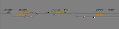

Here are some of my ideas for remodelling the Exeter area:

Newcourt would be good, home to the Ikea superstore. Perhaps extra large luggage stacks could be included on the trains to accomodate flatpack purchases! Something like the following perhaps:
Notes:
- New terminal platform same side of formation as through platform to avoid costly access bridge at Newcourt.
- Digby & Sowton constrained by access walkways constructed on former second track.
- Gratuitous addition of new station at Whipton to serve local housing and employment including Met Office.

The junction might be doubled with a shorter double track section reverting to single before Polsloe bridge station for greater resilience without requiring a second platform. Quicker single line clearance might also be arranged with a lengthened 'Penryn/Dovey Jn style' platform with the double to single turnout situated part-way along it. Improvements to the poor steps, then ramp, then steps again access are really required for the single platform.
Something like this perhaps:
