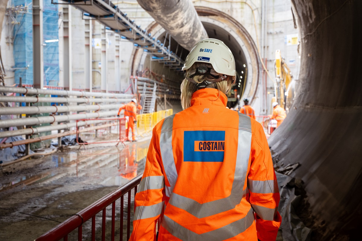

Contain has now formally announced its £400m contract for tunnels and lineside. Starts Q1 2025, runs for 7 years (with possible extensions)
  • £400m award will deliver critical lineside mechanical & electrical systems for the UK’s new high speed rail link.
Costain, the infrastructure solutions company, has won a major contract to deliver tunnel and lineside mechanical and electrical (M&E) systems for HS2.
Costain will deliver the design, supply, manufacture, installation, testing and commissioning of HS2’s Tunnel and Lineside M&E systems during construction. The total contract value is worth a minimum of £400m to Costain. The contract, to be signed in due course, will start in Q1 2025 for a seven-year period, with the option for additional contract extensions.
The M&E systems installation will include services within the tunnels, together with cross-passages, low voltage power services and distribution on the open part of the route. Costain will also design, supply, install, test and commission the tunnel ventilation systems.
