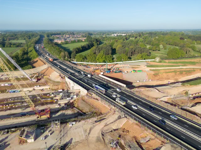

Dates of the closure Friday 11 April to Thursday 1 May of A46 dual carriageway for the slide of new under bridge have now been published.
The work we are doing
We will be pushing a new box structure to take the HS2 line under the A46 near Kenilworth. Once the box is slid into place, we will complete the remaining works; resurface the carriageway, reinstate the white lines and safety barriers ready to reopen the A46. While we deliver the works there will be increased construction activity, 24/7 operation, overnight lighting and some additional noise. We will minimise the impact on residents as much as possible.
When the work will take place
To ensure the safety of our workforce, we will be closing a section of the A46 from the Stivichall Interchange (Festival Island) to the Thickthorn Island (A452 for Leamington and Kenilworth) for 19 days. We will hold three days as a contingency in case of an unforeseen event
HS2 will bring a number of bridges into use during 2025 along the whole route, allowing existing roads blocking the trackbed to be removed and landscaped

New drone video of A46 bridge, concrete abutments appear to have been built, and pair of very large cranes erected either side.
stuving
26 Jan 2017
722
I've had a look for any relevant explanations of how this bridge slide differs from HS2's others, and there's nothing definitive. It is bigger, and it does have one big design difference, but the fundamental method is the same - Freyssinet's autoripage.
The one major difference is that Radlett and Coventry had vertical flank walls, and the embankment had to be backfilled up to that. Kenilworth has sloping walls, serving as a struts supporting the ends of the deck of the box. Backfilling under that is clearly a more difficult operation, depending on how much support that fill provides for the bridge (which is unclear, at least to me).
There is an HS2 CGI of something similar to the Kenilworth slide (here from Construction Management magazine), though it isn't exactly the same in its details. Assuming the five plates scattered around the crane on each side form the transition from bridge deck to intact roadway, that's what the cranes must be there to lift. Mind you, five plates looks to few to span the full width of the deck.
I also found a "how to" video from Freyssinet about Coventry here, which illustrates the technique and in particular the hidden bits like the cables. Most of the text you read (e.g. HS2's used by most other publications) is a bit misleading in talking about the box being guided by a raft. The box (bridge and floor slab as a rigid unit) is built on a slab, with a sliding joint between them. Then the box is pushed off the end of the slab onto bare earth with a pool of bentonite lubricant on top. At the end of the slide the box is just off the end of the slab, and the jacking rafts are still on it. Freysinnet's video of Radlett is also worth a look.

A video update as of 1130 this morning (18th April) shows the slide was complete by then and the cranes installing the ‘transition plates’ that @stuving mentioned in post #105. (Quite a few more than the number visible earlier, by the way.)
It is becoming clear that the 19 day programme must have included massive amounts of contingency.

A new drone video of A46 at Stoneleigh and HS2 bridge
Cranes moving the plates to hold the roadway either side of the new bridge have now gone. Work appears to be ongoing to backfill / build up either side of bridge ahead of restoring the road.
< Automerge >
Drone video 24th April
Road looks like it has been surfaced, and work is now on barriers
11,064
New drone video, Road now has white lines, and temporary barriers limiting traffic to 2 lanes each way.
A46 Road looks virtually ready to reopen.
Update 30th April
A46 open
  • The A46 Kenilworth Bypass reopened to traffic at midnight last night – 30 hours ahead of schedule. Download new images showing the road open to traffic this morning.
  • The 18-day closure was to allow HS2 engineers to slide a massive 14,500-tonne box structure into place which will carry high speed trains under the road. View and embed timelapse footage of the slide.
  • In order to avoid two years of lane closures and speed restrictions, the huge concrete box was built in advance on land next to the road and slid into position during a continuous closure provided by National Highways.
