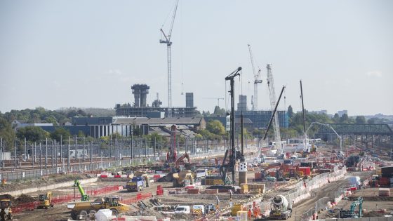

HS2 contractors make progress on station box, piling and utilities at Old Oak Common​
Work to construct the station, which will be the largest built in the UK in one stage, has accelerated during 2022 and the progress made on site is showcased in a new video (above).
HS2’s station construction partner for the station is Balfour Beatty, Vinci Systra joint venture (BBVS JV).
Excavation works in the station box, where the platforms for the new high speed trains will be constructed, have been rapidly progressing with over 70,000m3 of London Clay already removed. The box is being excavated using a top-down construction method which allows the ground floor slab to be poured before large excavators are used to remove earth from underneath.

Some more info on the HS2 page:
The box will be 130m in length and 24m deep complete with 1.5m thick walls constructed by diaphragm piling method, with top and intermediate levels of reinforced concrete props.
There's also a video there from the start of November showing the first of the support walls being installed, so there seems to have been quite a bit of progress since then, guessing it's close to full depth at the western end
