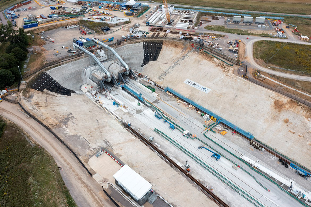

More TBM progress updates are available. https://www.hs2.org.uk/in-your-area/map/#11/51.6566/-0.3773/filter=hs2-stations,hs2-network
After something like 8 weeks of good progress (over 20m/day), the Chiltern TBMs (Florence and Cecilia) have now slowed to a crawl in the last week.
Both TBMs are past the 4km mark, so have completed over 25% of their bores.
They are just short of being mid-way to the second ventilation shaft at Chalfont St Giles.
TBM Dorothy continues to make good progress (around 9m/day) at Long Itchington and at 868m is close to 60% completion of its first bore.

For those interested in rates of progress of (Chiltern) TBM's, stop starts and so on, there's some interesting information in the linked presentation.
21,964
A very interesting presentation from the people doing the work.
It demonstrates why tunnelling progress has been so variable and will continue to be so as the logistics challenges increase with tunnel length.
Frequent TBM maintenance in the flinty chalk is also a factor.
There was also passing reference to a "fire" being under investigation.
There's a couple of minutes on the fire from 22:00 which is the start of the first talk (the 22 minutes up to that point are society business and introducing the speakers). It says roughly the same as this news report:
Tunnellers digging HS2’s Chiltern tunnels were trapped for 13 hours after a fire broke out on Tuesday night.
HS2 Ltd has launched an investigation into the fire near the Chiltern Tunnel South Portal site in Rickmansworth, just inside the M25.
The fire was on a vehicle that transports workers into the tunnel to work on the tunnel-boring machine (TBM). While transporting three workers who were on their way to a night shift in the TBM, Cecilia, the car caught fire. The workers removed themselves safely from the car and attempted to extinguish the fire, but the engine exploded about 1.6km from the TBM.
The three workers followed safety procedures and sheltered within Cecilia’s safety chamber. Once the fire was extinguished and the situation under control, they were removed safely from the tunnel. Reportedly, they were within the safety chamber for a full 15 hours, from 7pm on Tuesday night until 10am on Wednesday morning.
Emergency services attended the scene, but no injuries were reported. The TBM was untouched by the fire.
