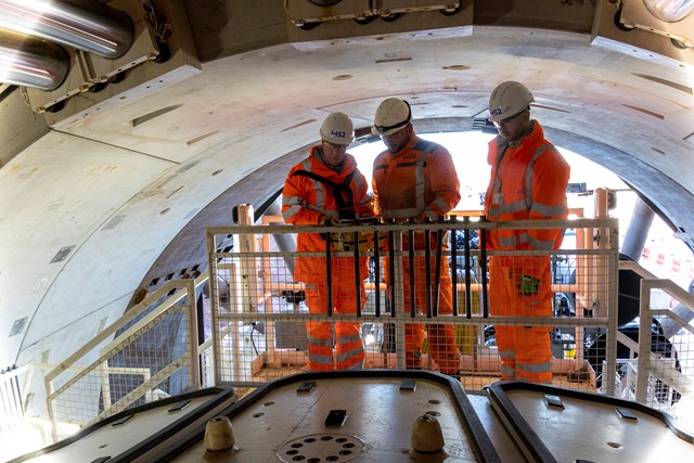

That looks quite close to the surface
They are big machines and perhaps the scale is deceptive. If I grab the image, cut out a dude in a orange outfit and stack them up, I'd guestimate the TBM crown is about 8-10m below ground level.
In case anyone is not aware, tree roots do not burrow down into the ground as deeply as one might think, though it varies a bit depending on species. They tend to be near the surface where the water, nutrients and air is thanks to all the little critters churning the soil, dead leaves, etc. There are pictures and articles on the subject if one Googles.
More interestingly to me, one reads that there needs to be a certain about (mass) of material above the TBM ingress/egress points to resist the "up thrust" from them disturbing anything above. Or the ground needs to be treated (e.g. grouted) to stiffen it up a bit (or a bit of both.)
yep TBMs typically need 8-10m cover.
yes, lots of examples of grouting ahead of TBMs running shallow.
