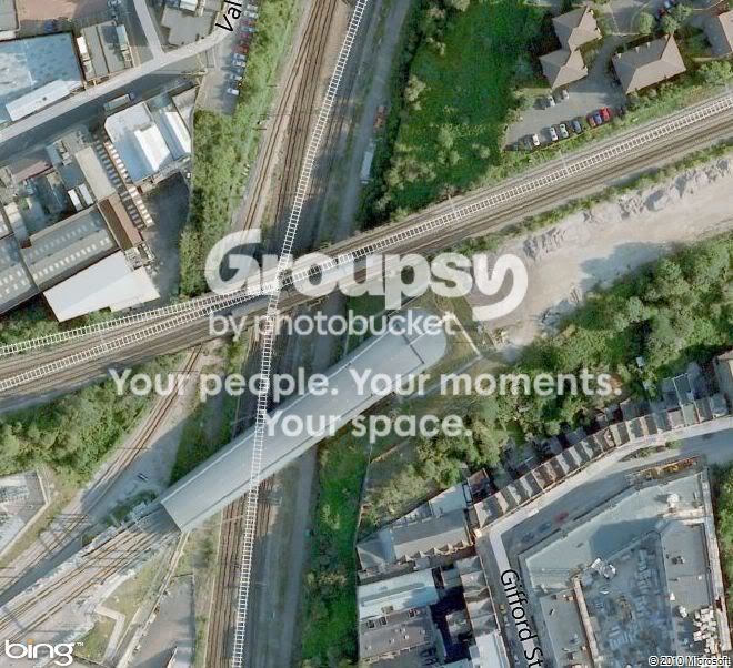

He's talking about this, over the ECML north of Kings Cross.

That single track line running from west to north in the picture; is that the line which will see trains from the GN running through to St Pancras?
Nym
2 Mar 2007
9,784
Somewhere, not in London
IIRC no, there is a tunnel, just visible at the bottom of frame, about 1/8th of the way across, you can just see the tunnel portal, this is going to be a 2 track link to Platforms A and B, the track hasn't been layed yet though. The track I think you're on about leads to the North London Line, and possibly the domsetic platforms at St P and the E* ones, for reigonal E* up the ECML

There seems to be a second link alongside the portal leading towards the junction with the NLL chord. Is that just an access road or is it a future connection from St Pancras itself to the ECML?
The entrance with no line laid is the tunnel entrance to the future connection from the ECML to the underground Thamslink platforms A and B at St Pancras.

that's the chord to st pancras international (and hs2 domestic) and the north london line? I think that's what you're referring to anyway. i've uploaded a huge composite image if that helps?
In between the two!!!
Oh, so there's already a direct connection from St Pancras International to the ECML, just no track down, sorry. :oops:
Looks like what I was looking at was an access road after all.
