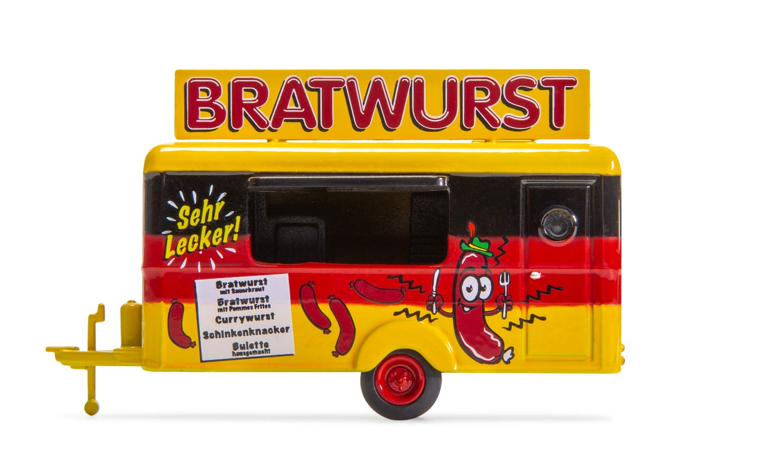

I've had a few ads on Facebook from Hornby. The recent ones have been for Lima HO scenic accessories. I like a lot of them.
My question is - do HO accessories look out of place on an OO layout? I know that adverts used to say HO/OO.
Thanks in advance.
