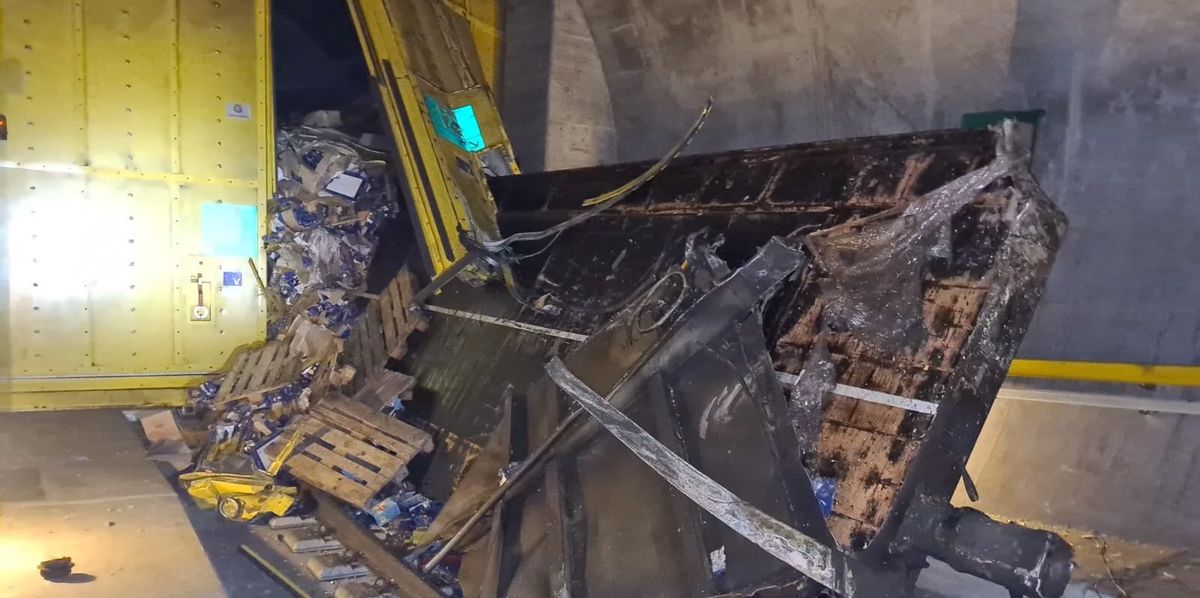

Reopening not expected to be until August 16th - some photos of the mess in the tunnel in this report from German-language Swiss newspaper 'Blick':

A freight train derailed in the Gotthard base tunnel in the afternoon.
According to the SBB, the base tunnel will therefore remain closed until midnight on next Wednesday, August 16th.
Until then, passenger trains between German-speaking Switzerland and Ticino will be diverted via the Gotthard panorama route.
This extends travel times on the north-south axis by around an hour. According to the SBB, train cancellations are also possible. Due to the diversions over the mountain route, the return holiday traffic and the Street Parade taking place at the weekend, there will be heavily occupied trains, the SBB continues to write. Standing room is to be expected.
According to an SBB media spokeswoman, a freight car derailed at the multifunction point in Faido. The multifunction station is one of two emergency stops that the tunnel has. The trains can also switch from one tunnel tube to the other there. In addition, the multifunction stations contain systems for the operation and maintenance of the tunnel.
According to the SBB, what led to the derailment of the car in the tunnel is just as unknown as the exact extent of the damage. Experts will now examine the damage and check for possible damage to the roadway and catenary. The Swiss Safety Investigation Center (Sust) had been summoned. There will be more information at a media conference in Bellinzona on Friday.
"The damage is considerable," said SBB spokeswoman Roberta Trevisan in the evening to the daily news of Italian-speaking Switzerland RSI. However, it is still too early to make an assessment and talk about possible causes. As far as passenger transport is concerned, the spokeswoman recommends travelers to find out more before driving through the Gotthard.
The Ticino canton police announced in the early evening that several wagons had derailed, some of which contained dangerous goods. However, these had not expired and would not have posed any danger. Nobody was injured. Significant damage was caused to rolling stock and infrastructure.

According to the Tages Anzeiger (Zürich newspaper) the derailment took place at 100 Km/h and there is severe damage.
Link is to the Tages Anzeiger with photos. Text is in German.
What happened?
Shortly after 12.45 p.m. on Thursday, a northbound freight train derailed at the Faido multifunction station in the Gotthard Base Tunnel. Significant damage was caused to rolling stock and infrastructure. "Enormous forces were released during the derailment," says SBB spokesman Rudolf Büchi at a media briefing on Friday in Bellinzona. “The freight train with 32 wagons was traveling at around 100 km/h – 23 wagons derailed in the incident.”
The train transported dangerous goods in several wagons. According to the Ticino cantonal police, however, these did not leak and did not pose a danger. Nobody was injured.
The multifunction point Faido is one of two emergency stops that the 57-kilometer tunnel has. The trains can also switch from one tunnel tube to the other there. In addition, the multifunction stations contain systems for the operation and maintenance of the tunnel.

"The damage is considerable," said SBB spokesman Rudolf Büchi. Apparently, the track system and a lane change gate in the tunnel were badly damaged when the freight train derailed. "The lane change gate is a security-relevant device for separating the two tunnel tubes," explains Büchi. «This is a custom-made product and cannot simply be bought on the market.» As soon as the gate is repaired, at least one tube can be opened again.

It includes 3 photos - one seems to show the damaged gate in the cross tunnel, another one shows bottles and cans strewn for some distance in a main tunnel, a third shows the wheels of a wagon on the tunnel track base with a broken rail. There's also a short video (in German) with an SBB spokesperson showing the position of the gate on a diagram.

This afternoon, at the press conference in Bellinzona, SBB reported on the incident in the Gotthard base tunnel. Apparently, the track system and a lane change gate in the tunnel were severely damaged when the freight train derailed. This safety-related facility is needed to separate the two tunnel tubes. Safety has top priority, which is why the second tube cannot be used for passenger or freight traffic.
Enormous forces were released in the derailment. The freight train with 33 cars was traveling at around 100 kilometers per hour, said Rudolf Büchi. 23 of the 33 cars derailed in the accident.
There are effects for travelers between north and south, for freight transport companies and the population in Ticino. This would have to accept longer travel times. With the temporary closure of the base tunnel, rail capacities at the Gotthard have been reduced by around a third.
The accident happened at the worst possible time, Büchi said. With the end of the holidays there is a lot of holiday traffic. In addition, the Street Parade will take place in Zurich at the weekend, with around a million people expected. Two extra trains from Ticino were planned for the Street Parade. According to Büchi, SBB is trying to guarantee this. Other extra trains were cancelled.
According to the circumstances, the engine driver is doing well, said Isabelle Betschart Kühne, member of the management board and head of production at SBB Cargo. He will be accompanied.
A problem with the train is suspected to be the cause. The track systems and the switches in the tunnel were fine, said Büchi. Due to the damage pattern, it must have been the rolling stock, so there was no danger for passenger trains.
There is probably no system in Switzerland that is maintained as intensively as the Gotthard tunnel, which has been in operation for eight years. There are two maintenance windows a week for checks and work. According to Büchi, no problems were found with the wheels or the load during the automatic check of the train in Claro TI.
Otherwise, the control system would have prevented the train from entering the tunnel. The alarm system in the tunnel did not work when the train passed through. "We don't know more at the moment." It won't be easy to find out why. There must have been a problem with the freight train with around 30 cars, said Büchi. The front part of the train in the tunnel has therefore not yet been released for salvage by the investigating authorities.
An exact statement on the cause and extent of damage cannot be made at this time. The Swiss Safety Investigation Board and the cantonal investigation authorities investigated the accident.

The latest from Swiss media is that a broken wheel is now the suspected cause. (To be precise, Radscheibe = literally wheel disc, I think wheel rim is the correct English term.)

If the axle had become derailed beforehand it may have been running along the concrete roadbed undetected for a while. The track is sunk in a trough with ledges either side that effectively provides continuous derailment containment along the plain line sections. Once the facing turnout to the crossover tunnel was encountered however, if the derailed wheel was outside the running rail on the turnout side that could have diverted the wagon in question towards the divergence and then following vehicles might also be diverted that way.
Re 4/4
30 Jun 2018
226
Bristol
I think that's the assumption, yes - based on the fact that the track shows signs of damage for a couple of km before the crossover.
Another problem is that the door across the crossover (which a wagon demolished) is safety critical for fire containment, so until it is replaced or repaired, no passenger trains at least can go through the tunnel even in the other bore.
