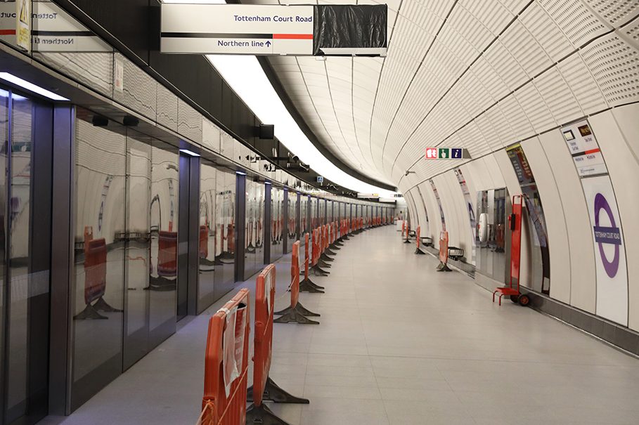

Tottenham Court Road:
St Pancras curvature is a challenge, although Farringdon would be another level entirely.
