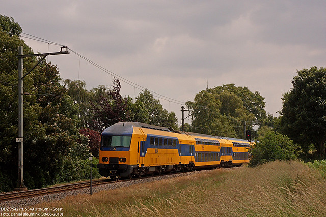

the mDDM-carriages in The Netherlands are similar, although with the engines on the lower floor and passenger area on the top floor.
And Bo-Bo-Bo configuration to make them even more unconventional!
DanielB
27 Feb 2020
1,459
Amersfoort, NL
Indeed! They got those six axles to prevent adhesion problems as they were built with 2400 kW of power to allow them to be as fast as Mat'64 (as on several routes a mix of double deckers and single deck trainsets were used).
What I didn't now yet, but just read, is the unconventional ability of the middle bogie to move sideways up to 15 cm. This to allow the mDDM to pass through curves.
Unfortunately however, the DDZ-trainsets which currently contain these carriages have been out of service for almost half a year now, due to uncommon vibrations which are being investigated.
