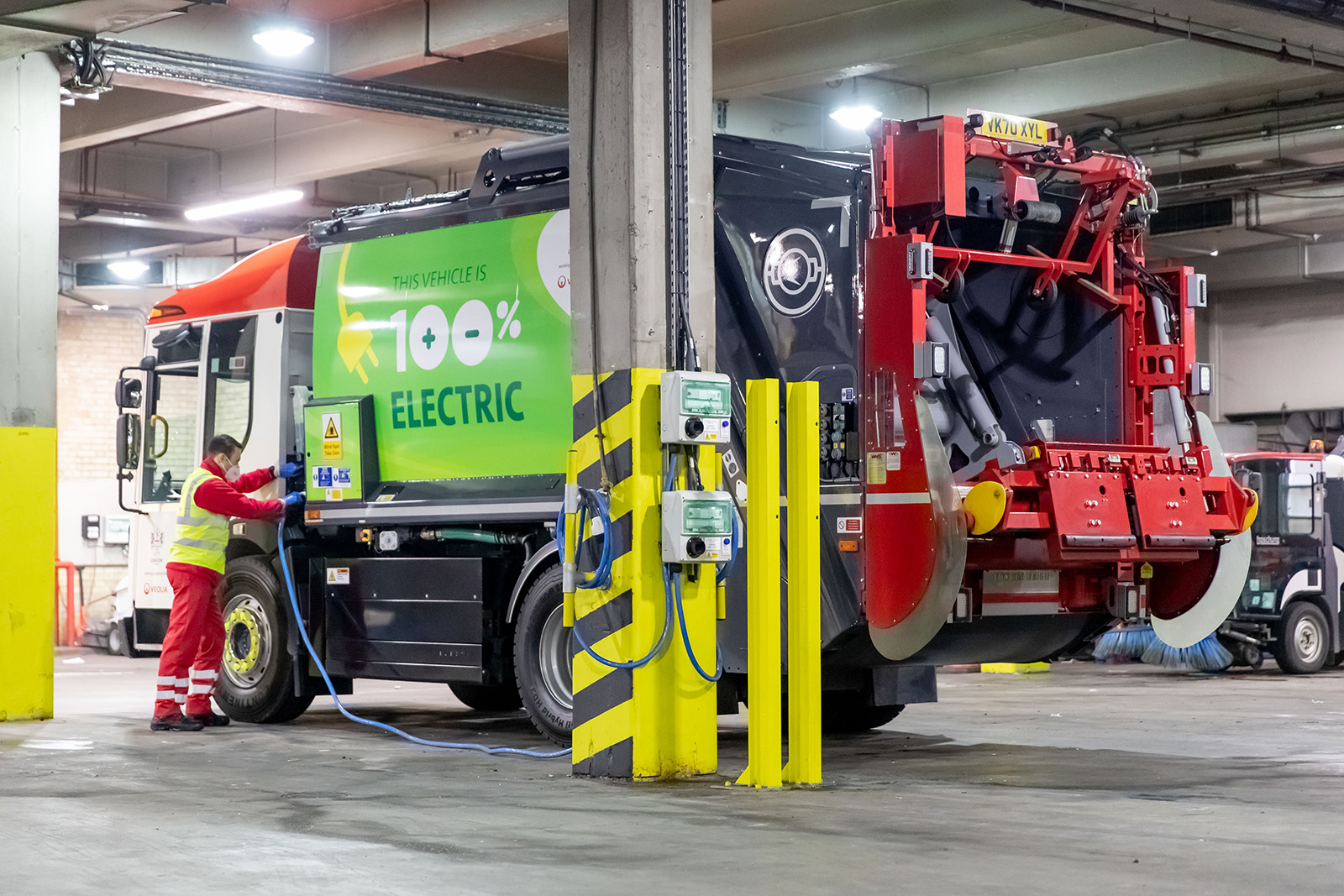

From time to time you see news reports about new recycling facilities opening up for handling lithium ion batteries. Report of a service opening up in Sheffield by a company RS Bruce, reports that Veolia are opening a facility in the West Midlands.
I think the battery recycling is a bit of a non-issue really.
