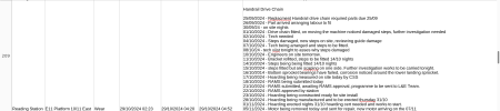

I FOI'd Network Rail for availability data again this year, and got a slightly better response this time around.
The more interesting document is the 'Periodic Business Review' which contains screenshots (sigh) of some business intelligence software. This covers the entire NR Western Route and I think it's particularly notable that (excluding the Paddington escalator, which is apparently a data issue - this is the one that was being refurbished and they intended to exclude it) all the Reading escalators are at the top of the unreliability list. The only one which met the availability KPI was the one at the North Entrance (which is not open to the weather).
The next slide has a breakdown of the wear vs 'external factors' data.
Most interesting to me is the paragraph at the bottom, which indicates that NR are well aware of the issues at Reading and are taking action to try and get on top of it. The 'resident engineer' is notable, as I've previously been told by NR that they have considered having an engineer based at Reading but it was cost-prohibitive.
There's also the maintenance log as CSV attached. Rather annoyingly, the "Work Completed Date" column doesn't necessarily mean that, so it's a little hard to work out actual downtime from that data (I wonder what they are using for the above BI).
If you scroll through you'll see that most of the issues are categorised as wear, with things like auxiliary brakes, corrosion, water ingress causing things to slip etc.
I would say it's pretty clear the escalators aren't fit for purpose (as has been suggested by others on here) and should be replaced by proper outdoor escalators, that are resilient to the environment.
I wonder how much NR spends on additional maintenance and callouts vs the capital expenditure of replacing the escalators entirely?
