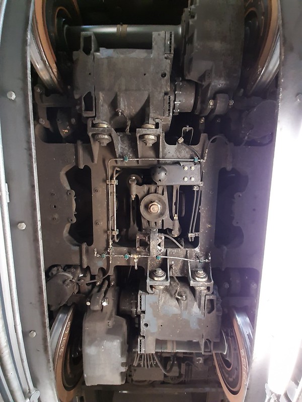

On 350s there's sometimes a thud when taking power after changing ends which is caused by the motors reversing and taking up the slack in the gearboxes.
By the way, these come under the asynchronous category of that site and are powered by IGBTs. Direction of travel is ultimately done by the sequencing of these IGBTs. The motor itself is mounted on the bogie frame and drives an axle-mounted double reduction gearbox with a flexible coupling.
