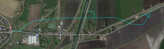

FWIW, thumbnail of my proposal attached. Black is existing retained, Red new link to KL line, Green existing Peterborough line abandoned. Cyan dotted box approx location of bridge and Dark Blue dotted lines potential future alignments for abandoning the West Curve should it be economically worthwhile. The road bridge would need widening of Low Road and then some land take on either side for an S-shaped crossing on the skew.
The only other reasonable alternative would be to bypass the whole village to the North and reduce the road traffic over the LXs.
Further to this, if the new junction was north of Ely West Junction then that also opens the West Curve up to enabling Lynn <> Norwich movements (granted probably only for freight or infrastructure), although that would need a sharper curve at the southern end of the new link.
The frequency of such moves makes running round at Ely or March/Whitemoor by far the preferable option.
This is an interesting option too, especially if grade separation is not required. It needs less new railway.
