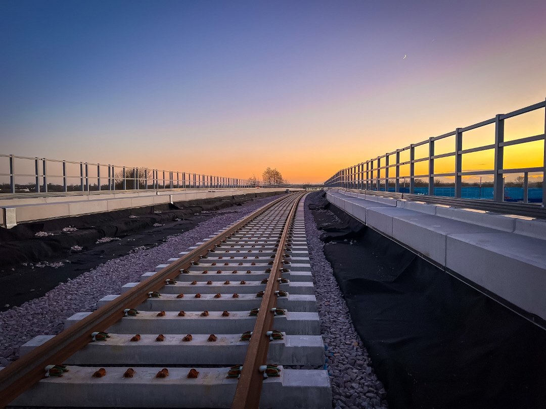

We know that one track has been laid across the new Bletchley flyover, from various reports and images. But how far does it go? Today I visited the overbridge on the Bletchley Leys Farm-Newton Longville road, and looking eastward as far as the outskirts of Bletchley could see no track.
Dr A.Johnston
6 May 2016
50
One track is down through the station to the end of the viaduct. The second track is due down shortly again to the end of the viaduct. Apparently the story I was given as to why they just for now finished at the end of the viaduct rather than part way, was that, if there was a run through it would come off the end of the tracks rather than the viaduct concreate if the line was short which is easier to fix (less structual damage), to me initially it sounded like someone had watch to many american films, but having thought about it, i guess it has some merit. Tracklaying from the Bicester end is due to start shortly. So some good photo opertunities soon.
But I guess there is someone a bit in the knwoledge who may share the full correct reason. Most likely contract reasons.

EWR have issued a Winter 2021/22 newsletter:
