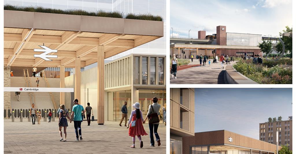

Cambridge eastern looks mammoth. That side is mainly residential although I am sure any spare plots will be developed. Won’t the additional platform (on that side) be a single side platform - vis the rather dramatic staircase?
It is indeed a rather dramatic staircase, I wonder why they aren't planning escalators like at Brent Cross West?
Yes platform 9 is to be single sided.
Cambridge Leisure Park and Hills Road College will both have much easier access from an east side entrance/exit.
Escalators I think would not work on the west side, where the existing station building is listed.
The eastern entrance at Cambridge would have been useful when I lived off Mill Road 1996-2000 and commuted to London!

Looks cheapskate to not have escalators there, when it's such a tall and wide staircase.
It might not have the throughput to justify them... it will definitely be far quieter. And there will be lifts.
