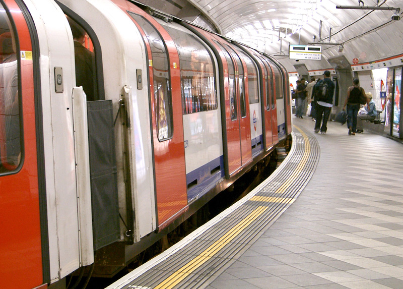

I don't think that has anything to do with it - there are parts of the underground with room for plural people to fall into the gap:
There are certainly routes where guard (or driver) operated doors would make a noticeable difference to dwell times, including pretty much every London inner-suburban route
And when people fall out of doors, get rained on and wind going through the carriage in the colder months and get blasted with hot air from outside (and if the train has air con break it?) in the summer months... ;)
Weather problems can be easily alleviated with a combination of a passenger-operated door close control, and automatic closing after $N seconds, as used on the LU S stock
Nobody wants to be on paper as making the decision to switch, only to get hauled in front of the courts if some wally gets themselves killed.
Having to keep getting up to close the door is a terrible idea.
A death, as opposed to a sore bottom, is extremely unlikely - if you are leaning on an opening door, you are not likely to remain upright enough to fit in a gap, and in the rare event that you are, a train will not move off with you still in that gap.
An exception to this is in the case of a wrong side door opening, presently more common on NR than on LU, where there is an automatic system to prevent this. Many modern trains also have automatic SDO systems, and these could be made a requisite for having guard/driver operated doors.
Hence the timeout before the doors automatically close themselves.
