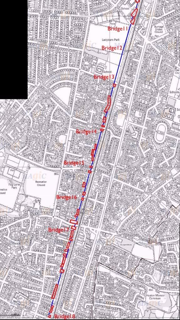

COPIED FROM OTHER THREAD:
Mayfield is the obvious place (if the western leg of HS2 terminates in Manchester)
Here's my latest thoughts on the route through South Manchester.
Starting from a New Mayfield on the South Side of WCML, take over the two south side lines on the six track viaduct down past the Longsight Depot before running onto the Styal Line - by singling the existing suburban service its not a huge undertaking to squeeze HS2 lines alongside it on the embankment between Slade Lane and the River Mersey - about a dozen bridges to widen, and there is about green space alongside 50% of this embankment on one side or other - with minor demolition or vertical retaining walls elsewhere. It gets a bit harder south of the river so some demolition required to get through Gatley and Heald Green but then build the HS2 Airport Station right on (or over) the airport triangle junction - use one side of the existing dual line (as a mini metrolink maybe) as the link down to the Airport Station. South of the triangle HS2 would diverge due South at the curve at Styal, dodging between Quarry Bank Mill and Styal before ploughing on south towards Lichfield (don't care after that there's plenty of space in Cheshire and Staffordshire)
Schematics and Birds Eye View of Slade Lane to River Mersey
http://photobucket.com/HS2Manchester
Red = demolition Blue = New Embankment Edge
