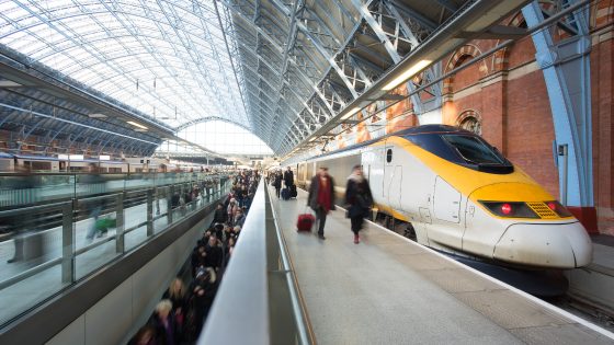

4 MARCH 2024 ·BY MERLIN FULCHER
Rail infrastructure operator HS1 is seeking a consultant to explore capacity enlargement options for St Pancras International station in central London [Deadline: 11 April 2024]
The company – which has a 30-year concession to run the 109km rail line between St Pancras International in London and the Channel Tunnel – is recruiting a team to carry out a capacity enhancement study focussing on the landmark William Henry Barlow-designed terminus.
The project aims to boost capacity at the congested St Pancras International where in coming years new train operators are planning to run services alongside Eurostar which itself hopes to increase capacity from 1800 passengers an hour to 2700 passengers an hour by 2025.
The winning team will explore how to optimise passenger throughput using existing infrastructure, how to unlock future growth and how such transformations can be achieved. Participating teams must complete an NDA to receive the full bidding documents.
According to the brief: ‘International services are currently operated by a single operator, Eurostar who have an aspiration to grow passenger throughput capacity from 1800 passengers an hour to 2700 passengers an hour by 2025.
‘We must also safeguard for the potential of other new international operators entering the market and wishing to run services to and from St Pancras International. HS1 is agnostic about where international growth comes from but is keen to make plans and facilitate growth, wherever it may come from.
‘Pre pandemic, HS1 had carried out various architectural studies looking at how international growth could be accommodated through a project known as SPICE (St Pancras International Capacity Enhancement), however many of the assumptions of SPICE have changed and the proposals need to be reassessed considering the latest information, technological advancements and growth assumptions.’
St Pancras station is a major central London terminus station which hosts international rail services to France, Belgium and the Netherlands. Designed by William Henry Barlow in 1868 – the Grade I-listed station underwent a £800 million refurbishment and redevelopment by Arup and Chapman Taylor Architects in 2007.
The upgraded station complex – featuring a £150 million overhaul and extension of George Gilbert Scott’s former Midland Grand Hotel designed by RHWL and Richard Griffiths Architects – features capacity limitations and long processing queues for international travel due to new border check requirements following Brexit.
The latest project comes five years after Chapman Taylor Architects drew up the ‘SPICE’ growth study for the interchange and delivered a series interim measures to improve the departure experience for passengers.
Bids for the latest commission will be evaluated 60 per cent on quality and 40 per cent on price. Applicants must hold employer’s liability insurance of £10 million, public liability insurance of £10 million and professional indemnity insurance of £5 million.

After the request for proposal in February 2024, the next step was the appointment in July of design agency Active Thinking to do a study into expansion at St Pancras. HS1 don't mention the competition, but other reports do say this was the winner.
The core of the study's brief was this:
A three-step approach will assess how to optimise the current station infrastructure, cater for continued growth of international passengers and examine the impact and cost of expansion.
The team of design specialists will investigate how modern approaches and technological solutions could be used to increase passenger flows through the station whilst ensuring customers continue to enjoy an efficient and seamless experience at the historic St. Pancras station. Active Thinking will deliver their report in Autumn 2024.
According to Architects' Journal, Landolt + Brown won the contest; but then they would say that - L+B are architects. They were part of the team; but since HS1 didn't mention them it's not clear whether they had their own study or were part of the one led by Active Thinking. (see https://www.railforums.co.uk/threads/eurostar-st-pancras-is-bedlam-normal.261987/page-8#post-6877952
for AJ report.
stuving
26 Jan 2017
745
The study's conclusion was that redesign could increase capacity, as reported in Railway Gazette on 12/12/24:
It found that expanded infrastructure and enhanced border security processes could increase capacity from 1 800 to around 2 400 passengers/h in the next three to four years. Redesigning the layout of the international area could see an increase of up to 5 000 passengers/h in the long term.
Soon after, news appeared of a tender for an implementation study, and that was posted officially on 23/1/25. It's official title is: HS1 Ltd - St Pancras Enhancement Project (STEP) – RIBA2 Design and Operational Concept Feasibility Study; HS1 Reference: HS1/ENG/2024/198.
International rail services are currently provided by Eurostar who have expressed an aspiration to grow their passenger volumes from 19m today to 30m by 2030 across their network. To support these growth aspirations, HS1 has commissioned an initial feasibility study to explore a) the likely future passenger numbers that will need to be accommodated in the international part of St Pancras station and b) the required spatial and operational changes that will be necessary to unlock the required capacity.
This initial work has identified that expansion is feasible. HS1 is now ready to progress to design and operational concept feasibility stage (RIBA2) to design, deliver and operationalise a reconfigured ground floor operation of the International Zone delivering a significant uplift in passenger capacity that meets forecast requirements until at least 2035 and potentially 2040.
Currently it's the PQQ that's open, for which the background information provided is very limited. Presumably it's only after registering that you get told more about this "feasibility study", let alone get to see it (you've now got less than a week to register!)
There is a PDF of the call for competition that lists the project requirements:
The end output of Project can be described as:
• An International Zone operation capable of handling and processing up to 5,000 passengers in a rolling 60-minute period and;
• An International Zone that has the appropriate facilities and operating model to accommodate at least one new international operator.
In providing a RIBA2 design and operational concept that will achieve this output bidders are asked to focus on:
• The spatial, architectural and other design elements including:
o Overall capacity provision;
o Improved passenger flows;
o Access and egress;
o Historic Building impact;
o Fire and evacuation safety;
o Station security design standards (SIDOS);
o Maintenance;
o Location, size and potential rationalisation of station facilities (Toilets, Operator facilities)

A fascinating read, published today - definitely some useful hints at what they're imagining: https://www.newcivilengineer.com/la...st-pancras-international-capacity-06-02-2025/
“Active Thinking comes from more of an aviation background than us and I think we quickly realised what we were doing wasn’t a traditional railway station type project; we were doing a security and border controls project,” Thorp said.
The study concluded that, before any expansion needs to take place, “we could at least double what we’re currently getting out of the operational space in terms of departures throughput”, Thorp said.
The main recommendation, initially, is to implement a “high volume security system like you would see in an airport”, he continued. This will involve long lanes for passengers that will “reap the rewards of what Eurostar has done with its border operation, which they’ve doubled over the last 12 to 18 months”.
These improvements will be implemented over the next year to 18 months in order to get “about another 30% out of the current throughput”, according to Thorp.
That next phase will involve a big rethink about how people arrive at the station and providing them with more space.
“We’ve tried to keep it as cost-effective as possible; it’s about reconfiguring the space as opposed to building loads more stuff and infrastructure,” Thorp said.
“There is a lot of back office space and ticket office space that is not used in the best possible way. We will need to relocate people and then there is a large amount of just punching down walls and expanding out.
“If you can imagine [the current] arrivals experience at St Pancras, you come down off the platforms and there’s a reasonably large area that you walk through – it’s about turning about 50% of that space into a security facility. That’s going to be the bulk of the work.”
Other steps will involve the procurement and installation of new security equipment, working with stakeholders to ensure optimal pedestrian flow through the area and ensuring that the arrivals experience enables people to be dispersed into the station to wherever they need to go to continue their journeys. Rerouting of utilities will also be a major concern in this reconfiguration.
“We think we can get 15 long security lanes into that space and also increase the departure space by about 50%,” Thorp said. “That will give us more resilience so that if trains are running late and we need to hold a volume of people we can do that in a more comfortable space.

The result of that competition has been announced, being a contract has been awarded to Hawkins Brown Architecture Limited (Hawkins/Brown). Or at least i think that's it - these contracting notices are notoriously confusing. The details given are:
Awarded date 19 May 2025
Contract start date 19 May 2025
Contract end date 25 October 2025
Total value of contract £295,121
This contract was awarded to 1 supplier. Hawkins Brown Architecture Limited
To date, I have found nothing from HS1 or Hawkins/Brown.
