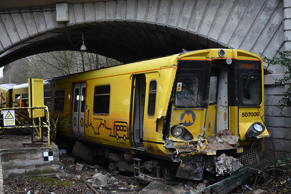

Derailment at Kirkby (Merseyside) - 13/03/2021

Please see previous posts discussing types that would be more effective at doing so than this one.
Most (if not all) of which require more space than is available at this location. Yes the train could stop further down the platform, but that might require platform extensions and/or signalling changes. either of which would be time consuming and expensive. Given that significant changes are planned here in the short term spending significant money on anything other than a like-for-like replacement would be a waste.
The history shows that on average a train will hit the buffers at most once a decade, the replacements should be in place far less time than that.
Yes, I've seen them. None of them would've made any measurable difference at the speed the train was going. If the others are more expensive, I'm not convinced it's a cost effective improvement. A better management plan would be improved TPWS/reduced speeds/non-technical skills management.
All most likely true at this location, but an unqualified statement that (all) buffer stops are ineffective at any sort of speed is somewhat misleading.
They would have made some difference by allowing uniform deceleration over whatever distance was available, rather than a sudden shock on hitting the stop and another one when hitting the walkway. They could perhaps also have been used in conjunction with a frangible surface in the platform walkway behind to increase that distance. This would have reduced the damage to the train end (where the driver might have been had things been a little different). Had the train been full and standing, it would probably have reduced the injuries from people falling over and hitting each other or interior fitting.
From previous posts I thought TPWS was already provided, and if so why it wasn't effective in stopping the train should be a key question for the enquiry. Assuming it is is in fact there, reducing the approach speed might be counter-productive as it risks the driver having to apply power to bring the train to the correct stopping position.
I also agree that assuming the extension of the electric service is extended, this probably will go away, so it's probably not worth doing anything at this specific site. But there may be lessons for other places.

TPWS is installed, in fact there are two installations approaching Kirkby - one for a permanent speed restriction of 15mph (reduction from 60mph) before the platform, and one at the standard distance before the buffer stop as there are on all dead end platform lines where TPWS is used and passenger trains run. But this shows the weaknesses of TPWS as a system compared to full ATP.
The train was travelling at a speed such that it was below the set-speed for the first set of TPWS OSS loops (a fairly normal approach speed at that point, and those loops are 295 metres before the 15mph PSR starts) but it was still travelling way too fast for the second set of loops to be effective in stopping the train, and if the brake was already applied to the emergency position before the train reached that second set of loops (set at ~10mph) the TPWS would have had no material effect to what was already happening anyway.
It would be possible to employ further, multiple, sets of TPWS OSS loops on approach set at lower and lower speeds. This would effectively force the train to comply with a certain braking curve which would need to be below the set speed of those loops at every installation (or if the train speed was above then the resultant TPWS activation would cause an emergency brake application) but as with everything there's a cost-benefit ratio to be applied.
The mitigations that are in place approaching Kirkby from the Liverpool side were better than the mitigations are when approaching Kirkby from the Wigan side.

Without wishing to downplay the risks of overruns, there's a world of difference between running through the buffers in open air (though the over bridge and walkway at Kirkby slightly complicates things) and running into the end wall of a dead-end tunnel with low-height rolling stock which has space above allowing over-riding.
TPWS at signals is normallly designed so that if a train passes the OSS at just under the set speed, as long as it doesn't accelerate afterwards and the brakes and adhesion are normal it will be tripped at the TSS and come to a halt before any point of conflict. I'm not familiar with the buffer stop installations but I'd expect them to be similar, so this is still an important area for investigation.
No, buffer stop installations are different and are in no way related to OSS for any prior speed restriction (or signal).
The TPWS OSS for the 15mph PSR probably have a set speed somewhere between 35-45mph based on the layout, I don't have the set speed figure.
The TPWS OSS being set at ~10mph 55m from the block end would hardly have had time to initiate a brake application if a train goes over them at 25-30mph, which seems to be the case at Kirkby from the footage and other info leaked.

Update via the RAIB regarding the scope of their investigation and a brief summary of events:
At around 18:53 hrs on 13 March 2021, the 18:35 hrs service from Liverpool Central to Kirkby struck the buffers located at the end of the Merseyrail Northern line platform at Kirkby station. The train approached the station at around 42 mph (68 km/h), before an emergency brake application was made, slowing the train before it hit the buffers. The train then derailed and collided with a platform extension which links the Northern line platform to the adjoining Kirkby branch line platform. The derailed train came a stop under a bridge and clear of the branch line, which was not occupied by a train at the time.
Twelve people reported suffering minor injuries as a result of the accident, and significant damage was caused to the train and to railway infrastructure.
Our investigation will seek to identify the sequence of events which led to the accident. It will also consider:
  • the performance of the train and the infrastructure
  • any factors that may have influenced the train driver’s actions
  • the training, supervision and management of Merseyrail drivers
  • the processes used to assess and control the risk of terminal platform overruns
  • any relevant underlying factors
Our investigation is independent of any investigation by the railway industry, the British Transport Police or by the industry’s regulator, the Office of Rail and Road.
We will publish our findings, including any recommendations to improve safety, at the conclusion of our investigation. This report will be available on our website.
