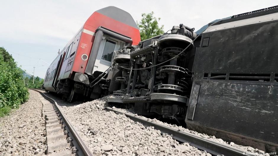

Reports are coming in of a derailment of a DB Regio regional train* on the Munich-Garmisch line, just north of Garmisch itself.
Pictures show several vehicles of a double-deck train derailed off the single track line.
There are reportedly 3 deaths and a significant number of injuries.

A few screen shots from the BBC Breaking news showing derailed double deck DB Regio carriages

There must have been some serious energy dissipated, for the vehicles to end up in the positions pictured.
The location is about 2km north of Garmisch-Partenkirchen station, and from the Schweers atlas is on a downhill gradient up to 2% (1 in 50).

The accident occurred around 12.15 p.m. in the district of Burgrain in the Loisachauen. Aerial photographs show that the train was travelling with double-deck coaches on a single-lane long curve. A switch is not to be seen. The section of the line is elevated on a railway embankment, several wagons slid from the dam into a small stream. According to initial assumptions, a fault on the track could be the cause.

Thanks. I was trying to figure out which direction the train was moving relative to the pictures. Is it me, or does it look like the track is buckled in the first picture posted by @Davester50 ?
(Though, it's entirely that was as a result, rather than being the cause of, the accident).

Video shown on Sky news, taken from the road, showed a side view of the loco beside an OHLE mast. The mast was damaged and seemed to be bent over in the direction of travel of the train.

I wonder if this might have been an overspeed in curve incident. The site at Burgrain is a fairly long curve of 450m radius, the first major curvature encountered about 2.5km after leaving Garmisch. According to OpenRailwayMap, the 100kph general line speed limit isn't further restricted locally for this curve and the figure seems reasonable for the radius, but if a train was going significantly more than line speed then this may have been the most likely location for a derailment to occur.

a) why imagine that the train was going significantly faster than it should have been? I guess it is not impossible if a loco was propelling just a few coaches though...
b) why would you expect this to cause the derailment? Our recent experience at Peterborough shows how well railways cope with speeds above what was intended.
I expect double-deck coaches have a higher centre of gravity than a UK 80x, especially when well loaded upstairs. Also a slow crossover, as at Peterborough, usually has a fairly short tight curve one way followed quickly by an immediate reverse curve the other way, so little of the train will be leaning the same way for very long simultaneously, whereas the Bavarian curve has a continuous 450m radius for over 350m. Electric trains can accelerate quickly. It's just one theory. The presence of the curve could also have contributed to the scale of the derailment if the root cause turns out to be some other mechanical failure or track defect, even if no speeding was involved.
