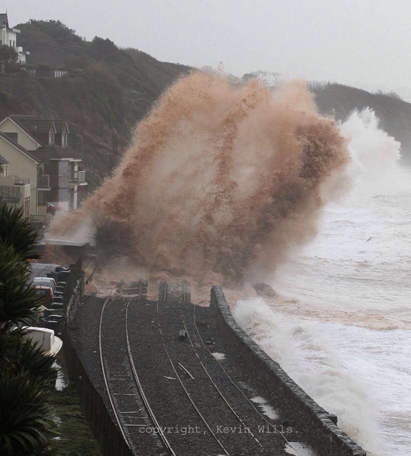

I'm guessing that this must have been not long after the breech given the colour of the spray
Bfu--JWIQAAVMQg.jpg:large

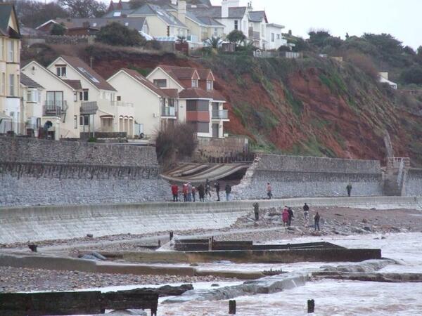

I disagree, obviously neither of us are civil engineers but if you look at the low tide pictures it would seem possible to rebuild the wall and then infill the section between the wall and the cliff, supporting both the new trackbed, the road and the house.
The footpath at the base of the wall (this is on the section where the footpath is a good 8 foot below the railway) is remarkably still intact.

There was footage on the news earlier of the general public on the footpath & beach taking photos, etc (when the tide had gone out). Also on the main thread.
