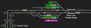

Just happened to look at my 'local' map a few minutes ago and saw that
the entire Lancaster station area was gridlocked!! o_O
(edit: 2Y02 subsequently went into platform one to reverse)
