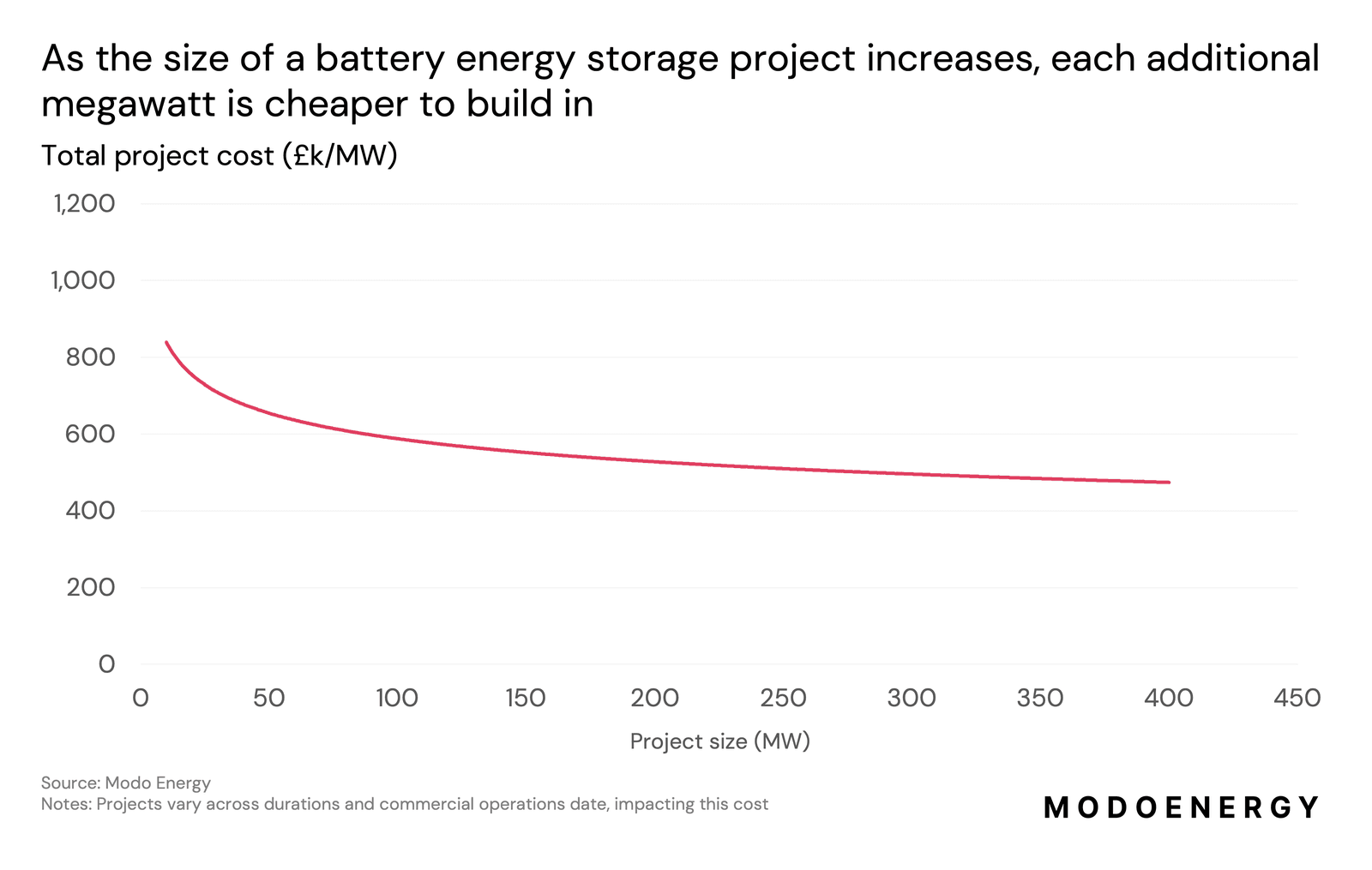

This article says that a 10MW grid battery storing 1.9hours supply would cost around £6 million, which for comparison is the cost of around 2-3km of new OHLE. I don't know how that compares to the cost of a stadard SFC or an 2 x 80MVA grid supply point like Braybrooke on the MML.
How much does it cost to build a battery energy storage system in 2024? - Research | Modo Energy
How much does it cost to build a battery in 2024? Modo Energy’s industry survey reveals key Capex, O&M, and connection cost benchmarks for BESS projects.
