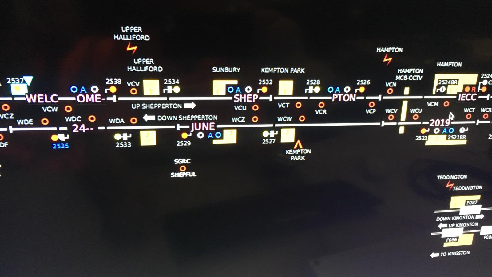

Indeed. To add to this some of the most advanced interlocking in use in Britain is the BomElectrologIXS (pronounced electrologics) in use in the Feltham area amongst other places, which uses ladder logic and other equipment alterations to substantially reduce track side equipment, and therefore interlocking complexity. This was the first all new technology interlocking installation in the UK since the ones MarkyT listed above. This might be worth a look as it was the first use of this kind of interlocking on a major passenger railway in the world, off the top of my head.
I think the hardware is closely related to the Vaughan Harmon equipment used in Norfolk on the Cromer line. USA-based Harmon was taken over by General Electric, then the rail control division was eventually sold to Alstom.
An interesting article about Feltham here:
New main-line interlocking enters service
Feltham signal box is a large route relay-interlocking system dating from 1974 and it was high-time that it was replaced – resignalling had already been deferred and the asset condition was such that further deferment was not an option. The Shepperton branch was selected as the first stage of the renewal of Feltham signal box, with full renewal taking place in six stages over several years, such is the complexity of the Feltham signalling area.
