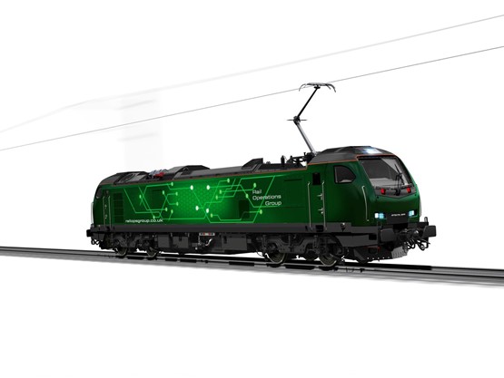

The way I read it was 30 ordered with 10 arriving in the first batch. Ten would replace the older 37's etc
Thirty Class 93 tri-mode locomotives will be built by Stadler for Rail Operations (UK) Ltd, with the initial batch of ten due for delivery in early 2023.
