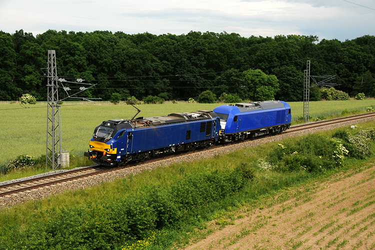

Here's the latest pics from railcolor.net, showing 88001 being tested with coal wagons in Czechia.
http://www.railcolor.net/index.php?nav=1000006&file=vl_88001_63&action=image
Rhydgaled
25 Nov 2010
4,859
Harbornite
7 May 2016
3,627
Is 88001 moving at all in that pic? And are the coal wagons loaded? If the answer to both of those is yes then the diesel engine must be surprisingly powerful because the pantographs don't seem to be raised.
Good question, I'm not entirely sure. There is a possibility although the loco has rear light markers on it. I'm attaching another image that shows 88001 with the pantograph up, and it shows the contents of the coal hoppers.

Could it be that the last mile diesel engine was being tested with being used with the coal wagons?

The full story of this was published several days ago. Apparently it did the first run on diesel power only and the second on electric power. It is more than a last mile diesel, though not anywhere near type 4/5 power, just type 1 (950HP), so it can in theory do the same work as a single class 20 on diesel power. Currently it is not possible to fit a more powerful diesel engine within the UK loading gauge undeer the new EU regulations. The EuroDual (actually PrasaDuals) currently being built for South Africa have a 2800HP diesel engine but they are higher when seen next to the 88s (two of each plus a Euro 4000 and Eurolight all together in the engine test bay yesterday).
There will likely be a lot more tests over the coming weeks in addition to further testing in the UK when the first ones are delivered before its true capabilities under various conditions become known.

That picture was taken when it was on its way to Velim. Testing usually lasts about 2-3 months. It may look like just another 68 with a pantograph but remember it is a totally different diesel engine and very different software to cater for the electric side of things. Granted the bogies and traction motors are the same.
Another thing to remember is that the loco is likely to be internally equipped with a lot of testing equipment which will need to be removed.
It is quite likely to return to the factory for this equipment to be removed and have the remainder of its parts restored to "as new" condition, as was done with 68001.
If the above is indeed the case I would not expect to see it in UK until towards the end of deliveries.

@Harbornite, the picture above should be credited to Norman Gottberg. You should not be posting other peoples pictures without permission or credit, it is extremely bad manners as well as copyright infringement.

Using the formulae here - http://www.republiclocomotive.com/tractive_effort_and_power_calculations.html - and waving a wet finger about to estimate 'power at the wheels', I reckon that an 88 on diesel could manage maximum tractive effort (317kN) up to about 4-5 mph, then TE falls off as speed increases as per the normal 'constant power' curve. As 950 hp is 'heavy shunter' power level i.e. what you might use to shove a whole train over a yard hump, that feels about right.
So yes, it could climb Shap with a heavy train on diesel, but slowly...but that is still better than not moving at all in the event of overhead power loss.
