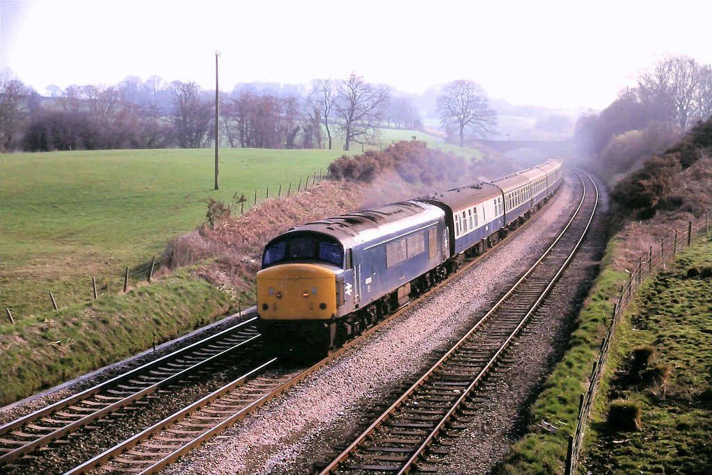

1976- 45 040 had headcode boxes at at that time:
1978- 45 040 with headcode boxes again:
45 040 in April 1979, no boxes or plates:
45 040 in June 1979, no boxes but plates have returned:
From those (very much assuming the dates on Flickr are correct), I'd suspect the photo was taken in early 1979.
Note: This also assumes that one end wasn't changed only due to accident damage.
Unfortunately, the Peak Diaries has got no data this late for 45 040, nothing relevant on DerbySulzers either.
