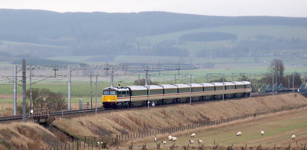

The main contractor on the Barrhead/EK electrification programme (SPL) are here as well, so they may well be using the same team on both projects. This, however, is much more complex with all the staging elements involved. Lots of existing structures on all points away from Carstairs have been renewed too, such as here at Strawfrank (to the south).
(Shot dated January 2022)
nlogax
6,049
Mostly Glasgow-ish. Mostly.
It's got S2 Bonomi arms, S1 Furrer+Frey arms - all it needs now is some token Alstom cLever arms and Siemens SICAT arms!
I do like seeing the F&F stuff appear in different parts of the country outside of the GE and GWML. The work at Carstairs looks to be pretty sizeable in scope and is a great demonstration of UKMS as a whole.
