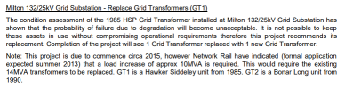

UKPN published a series of regional development plans (rdp) but they are all probably 10 years old this is the link for all of them. One can hope that things haven't changed since then. RDP5 for Burwell Grid Supply Point is the region that includes Melton so I found this information, I'm not sure if this is really what you were looking for though.
1739052052019.png1739050251097.pngUnfortunately, the RDP for the Kings Lynn area (#01 Walpole) does not mention the 132kV network at all. I don't why this is but it's exactly the same on the GEML side where Stowmarket FS is discussed but the smaller single feed at Norwich goes completely unmentioned; kinda interesting that the late '80s extensions of GEML and WAML/fen line wiring have very similar power design. A single supply FS nearby to the original extents of wiring (Ugley on WAML and Manningtree on GEML) followed by a full-size double supply FS at Stowmarket and Milton and then a (likely) low power single supply at each terminus.
For a general discussion, it's worth knowing about Network Rail's internal strategy for power supply going forward. Of course, it's not publicly available in any way other than being mentioned in this PWI video (
) for which they uploaded the slides. A few blurry images seem to suggest they might want new FSs on the branches at March, Whittlesea or Thetford.
View attachment 174251View attachment 174248Unfortunately, the RDP for the Kings Lynn area (#01 Walpole) does not mention the 132kV network at all. I don't why this is but it's exactly the same on the GEML side where Stowmarket FS is discussed but the smaller single feed at Norwich goes completely unmentioned; kinda interesting that the late '80s extensions of GEML and WAML/fen line wiring have very similar power design. A single supply FS nearby to the original extents of wiring (Ugley on WAML and Manningtree on GEML) followed by a full-size double supply FS at Stowmarket and Milton and then a (likely) low power single supply at each terminus.
The trend in recent years has been away from 132kV connections, towards 275 or 400kV supplies. This would almost certainly be the case for Walpole.

The trend in recent years has been away from 132kV connections, towards 275 or 400kV supplies. This would almost certainly be the case for Walpole, which is a Grid Supply Point.
I'd expect Kings Lynn FS and Norwich FS to be 132kV connections though, considering their age (1992 and 1987 respectively) and relatively low power consumption: Kings Lynn supplies about two train movements in an hour.
In any case, it's called Walpole because the document covers the area of Cambridgeshire/West Norfolk that is dependant on Walpole 400kV (six 132kV grid substations which supply 33 primary substations), not because it has anything to do with the railway.
