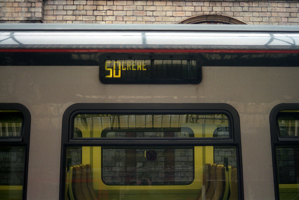

I found this photo on Flickr.
Not my photo, all credit to "Matt Taylor". Happy to remove if requested.
No problem, that's my picture taken back in 1995 and I think it was the first time I'd seen a 323, I also think that the 323s were the first to be built with a bodyside display panel.

Thanks, I thought it might be that, but it's always good to have confirmation!
Cheers for sharing. It's little photos like that which I love coming across. I could find plenty of photos of 323s in their early days but yours is the only one I found with a clear, visible (and legible) side display!
