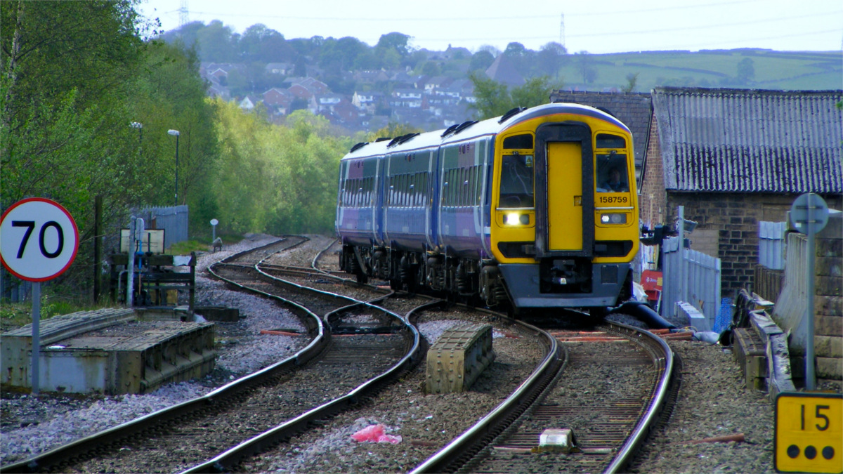

I presume they could not turn back here at Accrington as it looks to be controlled by a ground frame ?. (This looks like extremely grotty track to me, but I know nothing.) See photo : Accrington 158
Darren R
26 Jan 2013
1,252
Lancashire
The facing crossover nearest the camera is controlled by the emergency ground frame; the trailing crossover is signalled and controlled from Preston PSB. (Dunnow why they did it that way though!)
(Sorry - slightly off-topic!)
28,590
[/I]
Correct. I presume it was some sort of BR penny pinching.
However turnaround would only be possible here if the timetable allowed the train to stand on one of the main lines for its turnaround time without blocking any other trains.
