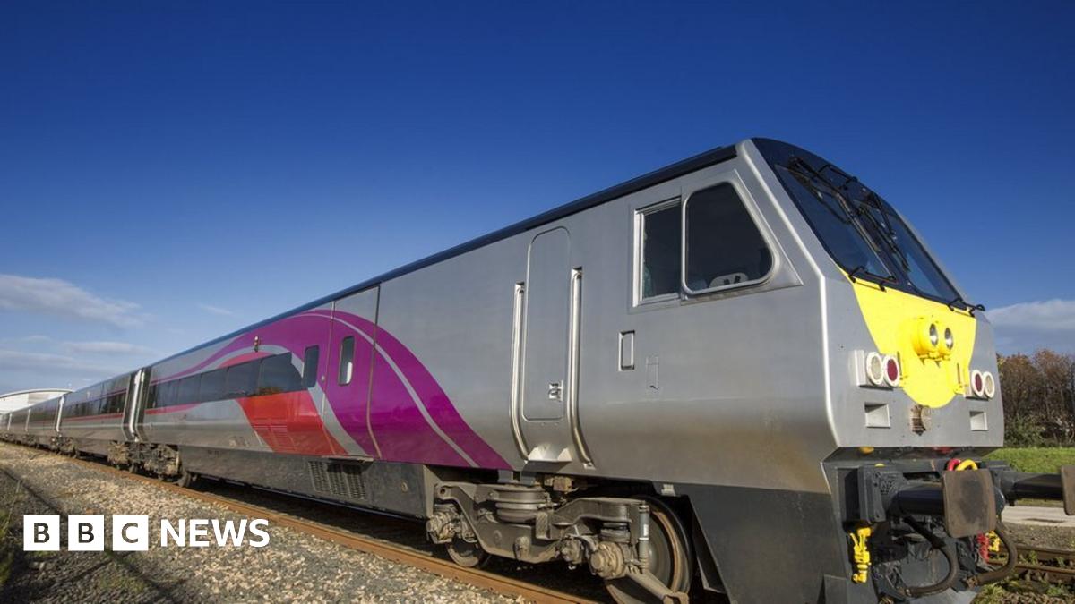

BBC News - Enterprise: Belfast-Dublin rail to receive multi-million investment
Cross-border rail services between Belfast and Dublin are set to benefit from a £141.9m investment.
The investment is part of the Peace Plus initiative which funds projects in Northern Ireland and border counties.
The funding will support a major programme aimed at providing an hourly service between Belfast and Dublin.
The thing is, the article mentions journey times will be reduced to 1hr 55 minutes.
Er, which it was in the 80s (admittedly when non stop services operated.
