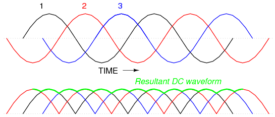

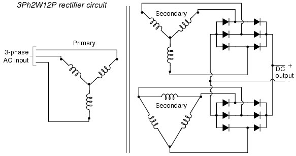

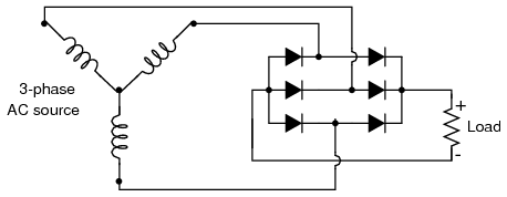

Anything that currently uses motor drives can be nicely run from any kind of DC sources, but even then it might require level shifts so you take what is currently a 3 stage controller and it becomes a four or five stage controller, running through 1ph or 3ph AC anyway.
Currently, HVAC and Motor Controllers use:
415VAC3P or 230VAC1P (415LN1P) == Rectifier == DC Link == Invertor == Frequency & Voltage controlled 3Phase AC == Motor
You'd need the DC from the PV Cells to be running very close to that of the current DC Links (about 550V) or you'd need to have a level shifter in there, and they are VERY complicated... I've seen one that uses 5 stages of transformers and power electronics before now.
