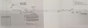

So it is unlocked from Barrow but ONLY when Dalton Junction SB is manned. Presumably this is based on verbal permission from the signaller rather than any interlocking?
Ground frames on the main line are always interlocked with the signal box. In Barrow there are two releases - lever 28 for the down main to up main crossover, and lever 29 for the down main to sidings crossover.
If you look at the photo you can see how the levers lock each other - I’ve attached an extract from the signalling plan which shows how things are laid out and includes a locking table.
Are signal boxes on the Furness Line often switched out? I've an idea Grange often is.
Carnforth Station Junction, Arnside, Ulverston and Barrow are continuously open. Arnside is unable to switch out as it controls stopping/non-stopping controls for an automatic level crossing. Ulverston can switch out but it doesn’t so do regularly.
Grange and Dalton Jn are only open on weekdays between 06:00 and 20:24.
