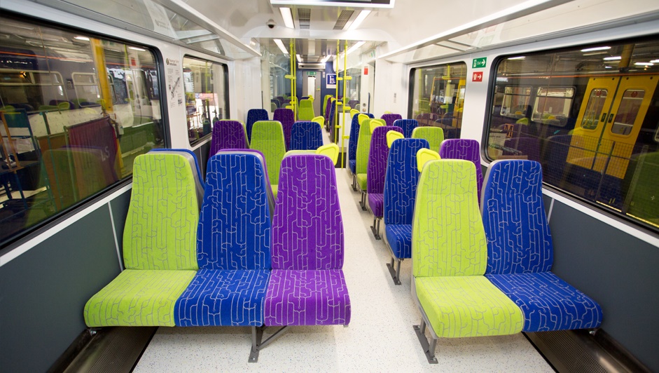

I thought that but the 321 Renatus project shows you can polish a turd. It's just up to the ROSCO and TOC to pull their finger and actually modernise the units for the 21st century. (i.e. air con, LED lighting, seats at right height, USB/charging sockets etc). Too many are too stingy.
Below is a 319 as is and a refurbished 321 "Renatus" - both were introduced in the same period. The transformation is remarkable when the effort is put in.
Meerkat
14 Jul 2018
9,276
I thought the Renatus I went on wasn’t very impressive. The floor covering and wall surfaces had the aura of wipe clean cheap cafe. Might partly have been the tone of the lights which was more bright security than welcoming.
Probably less obvious if they are busy though.
