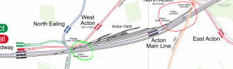

for context, this is Acton West Junction - this is where where the Up/Down Goods lines (aka the Poplar lines) start.
(Screenshot showing a track diagram of Acton west junction. from RAIB accident report: Collision between a passenger train and two rail-mounted grinding machines at Acton West 24 June 2008, page 8. Crown Copyright, document says reuse is permitted)
Slightly more up to date view:

Fair point! I was trying to convince myself that I’ve got the right location as Acton West junction doesn’t appear on Open Railway Map!
Acton West is a mainline, electrified junction. (highlighted green). Nothing required
Acton East / Poplars / Acton Wells is the rise up to the NLL (highlighted red here).
The red section is the bit that needs electifying to allow EMU traffic (primarily ECS 345s) to traverse the area. GWR 800x fleet could run bi-mode to Euston.
Don't think Acton Yard needs to be touched, nor will there be the HS2 funding to do so.
- HS2 aren't funding it.
- It's Acton West Jn - Acton Wells Jn that is being done. Acton East Jn - Acton Wells Jn isn't sufficient and doesn't work for the planned operations from Christmas 2026.
- Acton Yard is not being electrified.
- Acton West Jn is partially electrified, there is no OLE leading from the Reliefs onto the Down Poplar.

Not sure why you've quoted me as we are posting essentially the same thing but yes!
The Reliefs are of course already electrified but I suppose some are confused about the Goods lines which are adjacent to the north.
