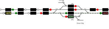

I'm currently travelling home on my late running 1s72 from Warrington, I found it quite interesting to note that my train and the avanti in front, both have a transpennine 397 in front of us, and even with the speed limit differential between the two class of trains, the 397s seem to be holding their own, neither of the two avanti trains have lost any extra time despite being stuck behind them all the way from Preston to at least Carstairs junction
Seems the acceleration on the 397 is making up for the higher speed on the 390 at least in these northern sections of the wcml
