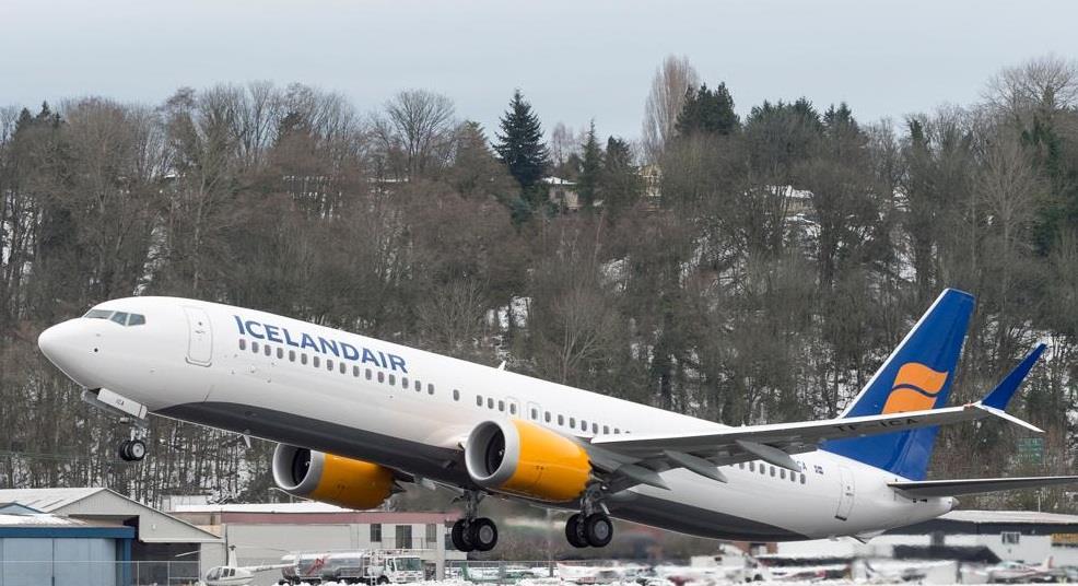

The rear mid-cabin exit door assembly separated from an Alaska Airlines 737-9 MAX minutes after take off from Portland on 5 January. The aircraft, registration N704AL, departed Portland (PDX) bound for Ontario, CA (ONT) at 17:06 local time (01:06 UTC +1). The aircraft reached a maximum altitude of 16,325 feet AMSL. It diverted safely back to Portland, landing at 17:26, reaching the gate at 17:30. The flight was carrying 174 passengers and six crew.
On the 737-9 MAX, Boeing includes a rear cabin exit door aft of the wings, but before the rear exit door. This is activated in dense seating configurations to meet evacuation requirements. The doors are not activated on Alaska Airlines aircraft and are permanently “plugged.” The door position in question is highlighted below inside the red circle.
N704AL (MSN 67501) was delivered to Alaska new from Boeing on 31 October 2023. It entered commercial service on 11 November 2023 and has accumulated 145 flights since then (including the incident flight).
AS1282 was the aircraft’s third flight of the day and second take off. It had flown from San Diego to New York overnight and then on to Portland earlier in the day.

<Attached image shows the rear ‘plugged door’ (window to Daily Mail) blown out>

Icelandair will join the club now due to the below:
European safety regulators have followed the US FAA in taking action against the Boeing 737 Max 9, after the Alaska Airlines depressurisation incident.
The FAA has ordered a temporary grounding of the Max 9 after a mid-cabin door detached from the Alaska aircraft as it climbed out of Portland on 5 January.
It states that the issue could affect other aircraft of the same design, and has ordered inspections before further flight of the aircraft.
The European Union Aviation Safety Agency has formally adopted the FAA directive, although it believes no operators in EASA member states are affected.
EASA says that, to its knowledge, and based on Boeing and FAA information, no European airline operates the aircraft in the “relevant configuration”, with the mid-cabin exit replaced by a ”plug-in panel”.
This de-activation is typically adopted by carriers with lower-density interiors, because the exit is unnecessary to meet evacuation requirements.
EASA says Max 9s in Europe do not have this configuration, and the aircraft are ”therefore not grounded” and can ”continue to operate normally”.Relatively few Max 9s operate in Europe. Carriers using the type include Turkish Airlines, which configures its jets with 169 seats, and Icelandair which has Max 9s with 178 seats.
EASA has now joined the club. Seeing as the UK doesn't have any 737-9 operators, I wonder if the CAA will choose not to issue an AD for this. Interestingly, this AD doesn't affect the 737-8-200 which has the same doors, O'Leary will be relieved.
