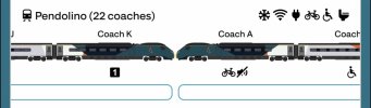

I’m guessing this is a fault as I can’t see how it’s possible but rtt is showing are 18:24 from oxenholme as 11 coaches?

It's because RTT have put the wrong information on display, again, as before etc etc
RTT isn't the problem, it's reading what's out there correctly, it's likely someone somewhere hasn't updated a program so after a unit swap you'll get something like this every now and then.
RTT are not putting wrong information on as such.
As has been explained many many times, Avanti have done set swap in there systems correctly, but, for what ever reason the systems take time to feed through things to things like RTT which is why this happens.

But it's not an RTT data fault, it's just to do with how long the relevant data takes to filter through when an allocation change is made.
It manages to get one half of the data change through quickly enough for something to surely be awry though?
If it was just a data update speed issue you wouldn’t get half the swap in a timely manner and half of it lingering on.
800001
24 Oct 2015
7,314
But that is what happens.
I have done plenty of set swaps. And then on RTT shows the original and new sets.
The swaps were silent correctly, so yes, somewhere in the system something lingers and causes these things to happen.
In this case. 9S80 was allocated:
  1. 2025-08-14 01:41 - 390132 on VW940
  2. 2025-08-14 03:21 - deallocated
  3. 2025-08-14 04:22 - 390115 on VW940
  4. 2025-08-14 07:16 - 390125 and 390115 on VW940
  5. 2025-08-14 07:21 - another message with the same content
  6. 2025-08-14 16:21 - 390125 on VW940
(all times are in UTC, so +1 hour for UK)
As always, it shows the data when it receives it.
There are issues with the data processes and feeds upstream of RTT that relate to this that everyone will discover in far more detail when it becomes open data but in the mean time, don't worry, just blame us :)
Apologies Tom I didn’t meant to come across as finger pointing at RTT directly; more make the point that somewhere in the black hole of cyber between me making a set swap instantaneously on the industry side and it appearing to the public on your side there’s something going awry and causing a delay to parts of it but not all.
That's not the point though. Whoever's error it is, the point is that it is an error and people really should be able to figure that out. It should be obvious to people on this site that a train upwards of five-hundred metres is not going to be running from London to Glasgow.
Trains of up to 775 metres run every night from London to Glasgow! Departing Camden Jn at 20:05 and getting to Coatbridge by 6am!
But it's not an error for the people who actually need to know what sets are running what service.
As on all the railways systems that staff is the allocations are corrects.
Thats a lot of data updates, I thought RTT only updated every hour or so

That ^. We aren't permitted in our legal agreements to include it in the API. That will obviously change once the data is opened up.
